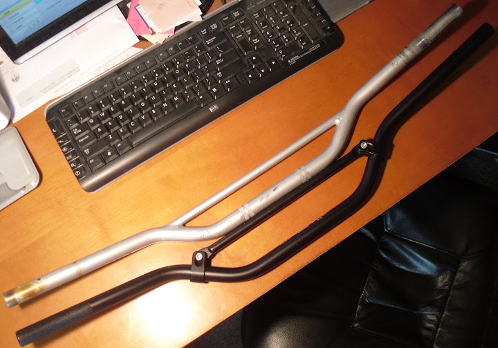

I ended up getting Renthal CR Hi black 7/8 bars and have the full HDB setup installed. I'll post some pictures later this week. It looks real nice! I'm happy with them so far, but have yet to go ride with them.......
Stock Bars VS Renthal CR Hi
They end up being about an inch wider and an inch taller with about the same pullback. Cables and everything seem to fit just fine.
