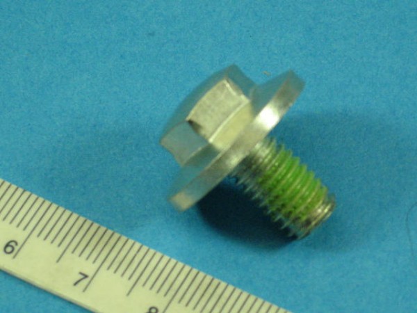

Not sure what you mean ?, I don't have the original bolt just whats shown....original bolt looks like this...
Honda Product No.: 28306KAE770
When the bolt is removed the spline shaft coming out of the engine sits flush with the kickstarter

Hi guys recently i removed the kickstarter and i found that the threads in the kick arm joint were worn all around the inside (towards the motor) i guess there is no way to cure this so a new joint is needed but for the price i will better replace the whole kickstart.
In the mean time i grinded the arm, now it works well but i will change it anyway. I hope to post a picture of the worn part just to put on a record for all of us.

Hi guys to update the post, i removed the complete kick arm and found that the threads in the bolt were worn so i guess this is the cause. i plan to replace the whole kickstart unit
