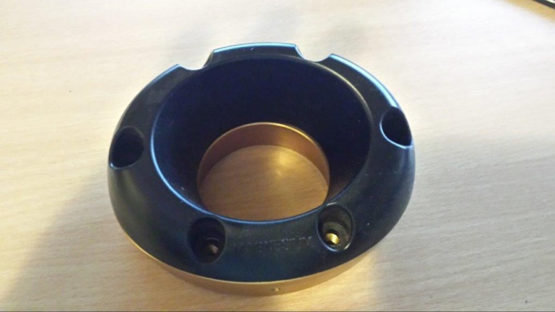

XR650SMR - only 1 zorst and here is the outlet
