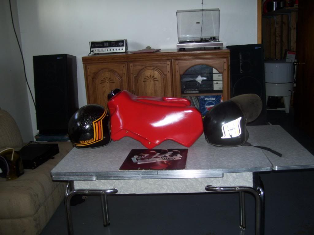

l missed out on a new ims tank a while back on ebay, bought one today its a Clarke model 16.3 litre which will be great for my riding time , a little more milage .

l purchased this clarke tank like l said 16.3 litre model . is their any thing l should know about this tank l thought l read some where they had issues . l did want a ims but whated a used one a liitle less coin .

I have the same tank and have had several Clarke tanks with no troubles. The only leakers I've heard of were IMS?
