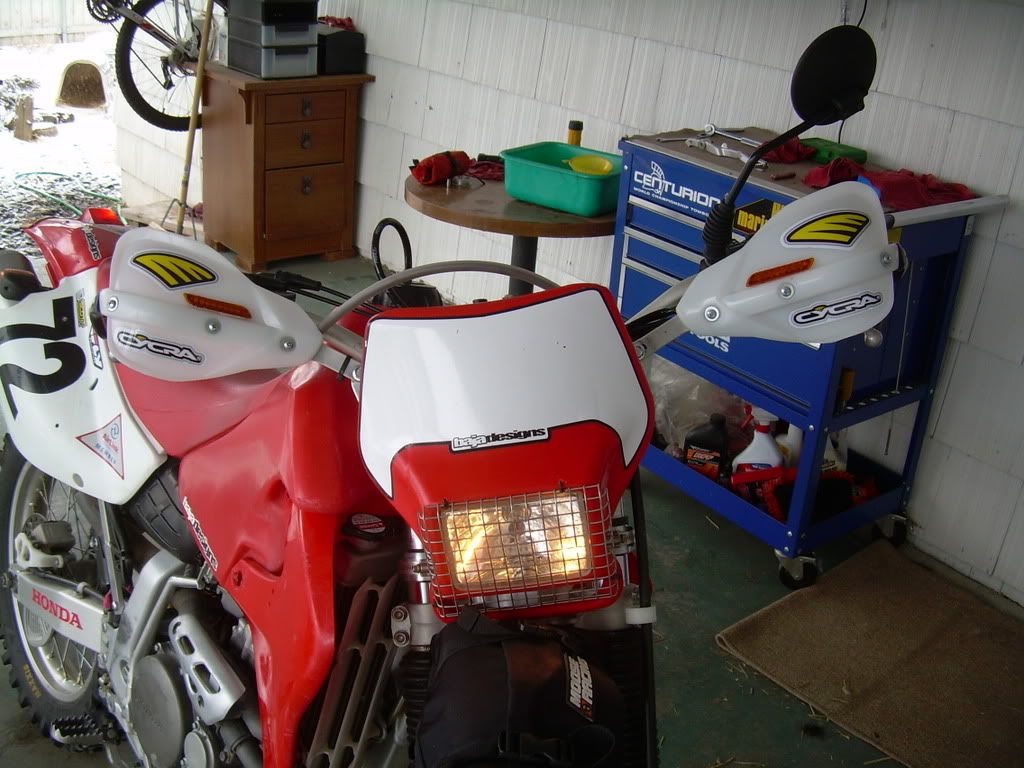

Both units installed on the bike (Excuse the missing headlight, more mods in progress ). I think it looks great, nice and clean! They are really bright for a small LED unit. Notice the yellow guard sitting on the belt sander; you can see the two different holes in it that I mentioned earlier.

Overall I’m really happy with the results. The Installation/Mod is a lot easier to do than the write up makes it sound; it should take about 30-45 minutes to install a set from start to finish now that I know the drill. If I hit a branch and break a guard or light unit it won’t take very long to replace it.
