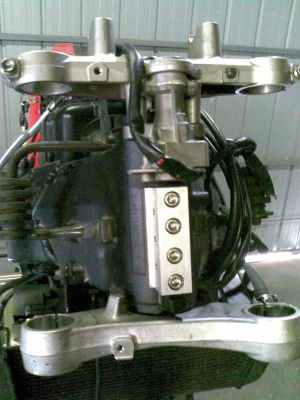

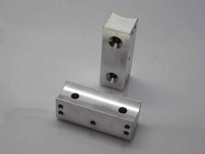

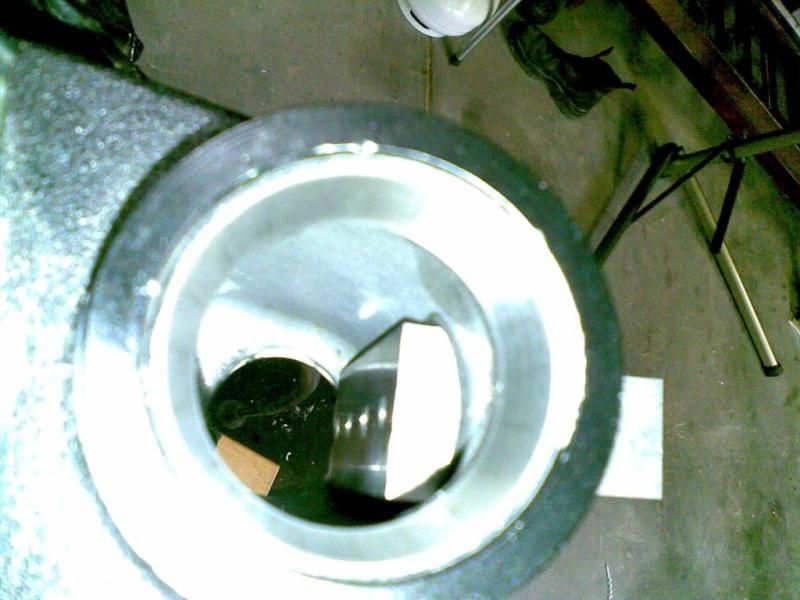

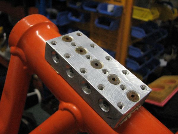

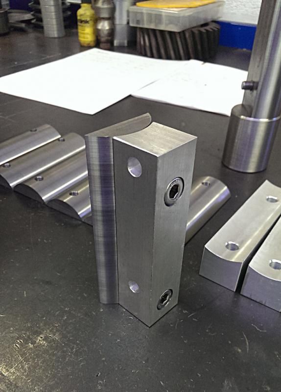

Post  Earache on Sat Apr 05, 2014 7:23 pm
SkidMark wrote:PM incoming....
I was thinking of something like this;
Has a metric shit ton of mounting options.

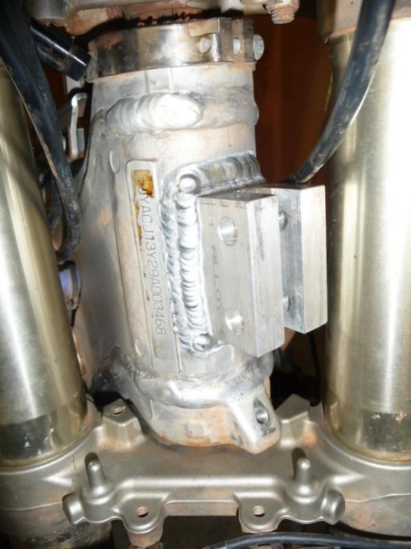

Ya could weld onto the headstock as well, like this...
But it's not reversible and maybe obscure the VIN stamp on your frame. I'm personally not a big fan of doing this. But it's the cheapest, easiest,quickest and arguably the strongest mount.
I like the idea of bolting on a mount on the outside and making a backing piece for inside of teh headstock, like this;
Earache

Post  SkidMark on Sun Apr 06, 2014 5:29 pm
I like the idea of the third example with the bolt on mount with the piece inside to add strength.  I will take some pics of the headlight but what I need to plan is how to mount it so it is adjustable to get the beam focused right.  Would be good if anyone on here has a KTM 990 could take a few pics of how the headlight mounts for inspiration...

Post  Earache on Sun Apr 06, 2014 5:34 pm
SkidMark wrote:I like the idea of the third example with the bolt on mount with the piece inside to add strength....
Agreed.
Welding that close to bearings has got to cause issues with the bearing races warping from the heat. Or at least I'd think it would.
Also, can anyone measure the inside diameter of their headstock? I don't wanna have to pull mine apart to measure it.

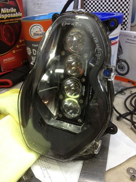

I'll get going on making a couple of these things as soon as I get back from vacation next week...
Should be pretty straight forward to make once I get the correct dimensions. Might as well make an extra in case I decide to use something like it on my bike.
Also need to get some dimensions on the 990 light - like distance between centers on the four mounting holes...
and also if the four hole s are on the same plane or if they are offset at all.
Check out this one, guy added some LED's to the 990 housing. Looks great and would be bright as shit - maybe too bright for the road....

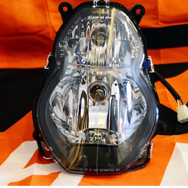

here is a pic from the back of my light - those four mounting holes seem to be to mount the headlight surround and screen to....
really need some pics of one installed to understand how it fits on a KTM.

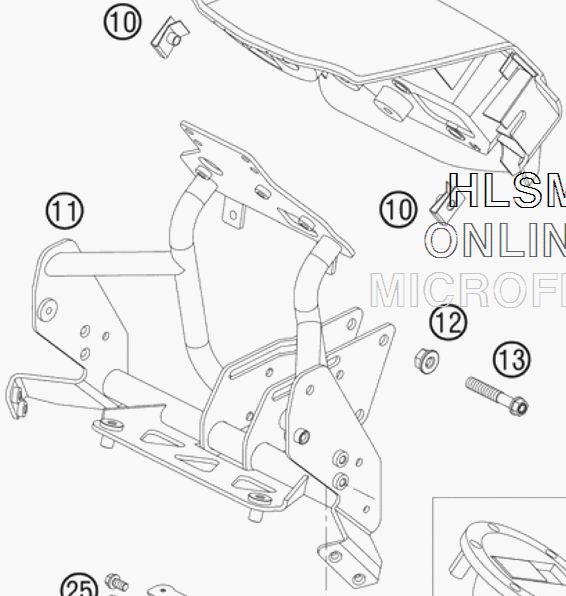

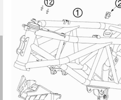

ok so done some more online research and the deal seems to be that the headlight mounts to the surround as my pic above shows then that surround mounts to a 'cockpit support' and the instrument unit that mounts to the cockpit support.
this thread shows some great pictures of the headlight mounting area.
Now my plan is to use a KTM screen but also to make my own cockpit so I would need some structure to mount this to - how far are you willing to go? if you just want to make the bracket to attach to the steering head then that is fine and would be really appreciated but if you able to make some sort of 'subframe' that the headlight mounts to and i can build a instrument panel off of then that would be even better.  what do you think?
Cheers
