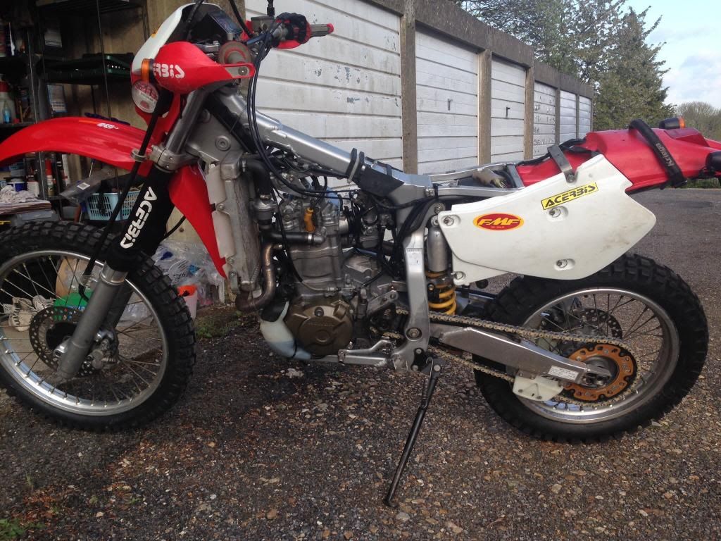

Finally got the bike back together and running. Sqeaky clean carburettor and jets. New float valve and 68s pilot jet. New chain and sprokets, (15, 45) new tyres, new XRs only thermostat, magnetic drain bolts and XRs only case saver. Brakes serviced and everything else cleaned and cleaned again.
Was a pig to start having altered too much at once in the carb, but now runs like a dream. No popping on decel, and ticks over nicely.
Now need to prepare for a one week jaunt to the pyrenees next month.

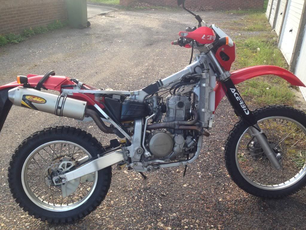

Post  R056rx on Sat Apr 26, 2014 8:31 am
Just testing my first photo upload....

Post  Zoro on Sat Apr 26, 2014 1:46 pm
Looks good, I'm running the same pipe except I have the Powerbomb header also.
Can't ride for too long without earplugs in..

Re: Running at last
Post  Mad Frosty on Sat Apr 26, 2014 4:32 pm
Bike looks great  nice
Does your exhaust can rub against the indicator holder ? mine does , dont get me wrong i like the FMF system as its OK for the money but its designed for the US version which has no indicators  shrug

Re: Running at last
Post  R056rx on Sat Apr 26, 2014 10:14 pm
Mauser! Next you'll be saying proper XRs don't have holes in the air box, 175 main jets or speedometers!  Frustrated
The indicator does touch the exhaust, but it doesn't seem any worse for wear. I'll have to keep an eye on it now. If I see flames in the rear view mirror I'll remember this post! dummy

Re: Running at last
Post  Zoro on Sun Apr 27, 2014 11:28 pm
My exhaust sits about 10mm below the indicator bracket, I must be lucky

Re: Running at last
Post  Mad Frosty on Sun Apr 27, 2014 11:41 pm
Nothing to do with luck , just with what exhaust system you have - how was it bend , the FMF system its the only one that sits so high , it looks cool and you can enter deeper water but it touches the bracket on non US bikes .
