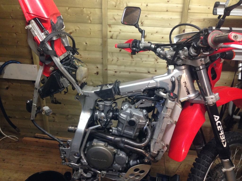

I managed to get the shock out without removing the sub frame. Just removed the tail pipe, detach the rear brake reservoir and remove the lower fixing bolts. Detach the air box boot from the carb, and the whole sub frame can be swung up out of the way.

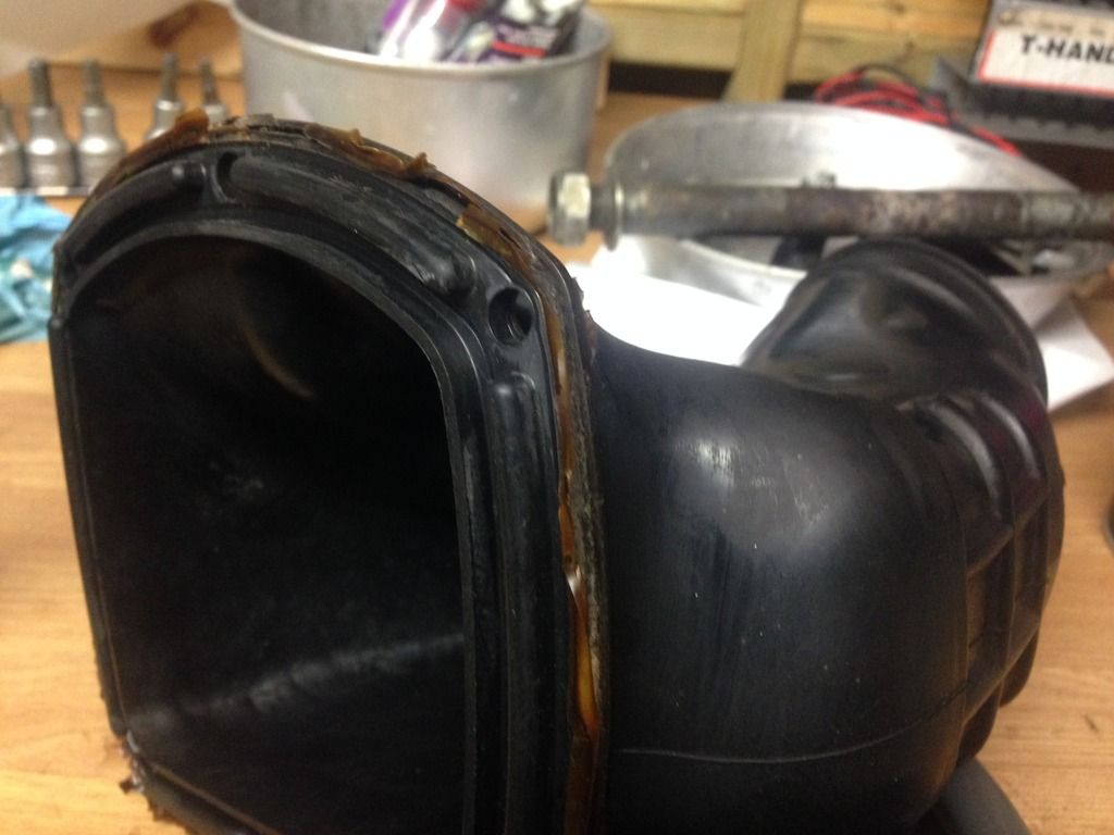

I had to detach the air box boot from the airbox to get to the shock bolt. When reinstalling, does this go back on the airbox with any sealant??

Wouldn't think Honda would use sealant on the air-box ?

Don't use sealant on the airbox to carby joint, make sure its clean and don't over tighten the clamp.

The joint I'm concerned about is the joint between the boot and the air box, not the boot and the carb. There looks to be the remains of some sort of sealant, hence the question. I can't find any reference to it in the manual.
This should clarify.....
Rear shock & greasing question <a href=Rear shock & greasing question IMG_2435_zpszmssgtyv" />

Still don't think Honda would install any sealant on the bike ?, maybe someone did this as an after mod ?.....does look like silicon though ?

I wouldn't put any sealant on it as long as it is in good condition (ie not hard and brittle). The most I would do is a thin smear of heavy grease. If it NEEDS sealant then you should probably be replacing it. Put it back on and then check for air leaks.

That's what I was thinking. Clean it up, put it back together and check for leaks. Thanks guys. 2 thumbs
