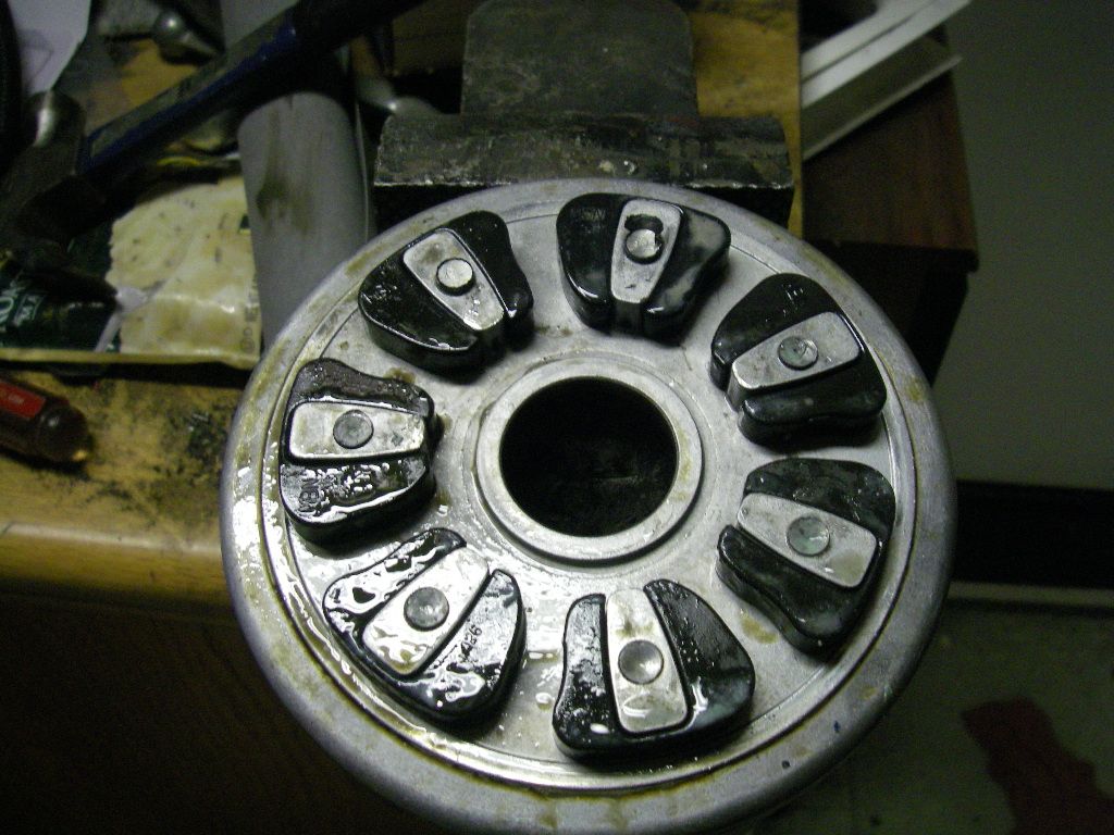

Post  Mauser on Mon Nov 21, 2016 2:11 pm
Welcome Wattsie, cush drive is built into the clutch.... razz
CUSH DRIVE IMGP8254
Posts : 1908
CUSH DRIVE Empty Re: CUSH DRIVE
Post  wattsie on Tue Nov 22, 2016 5:43 am
Hi Wassie hope to get up that way possibly next winter starting to plan a trip to the cape will be talking more about this soon . Mauser thanks for the pic I'm taking it that is with the rivets drilled and the gear off , someone at a recent ride did say to me that it could be in the clutch ,now I know its there it helps but with it on that side of the motor it softens the blows between the crank and the gearbox not the wheel and the gearbox , this may be enough dampening to stop gearbox wear from long sealed road riding . Have you or anyone else had any problems with high road use , if not I won't have to do anything which suits me fine. CHEERS wattsie Ps hope your partner appreciates that tounge of yours

Post  Mauser on Tue Nov 22, 2016 7:36 am
Yes drilled rivets....doesn't show these rubbers on any parts diagrams...maybe try the new rubber split link that Burps running Frustrated
