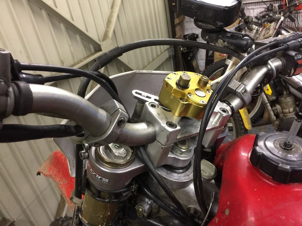

I had the Scotts front damper fitted.
Currently removed when I have fitted the CRF front end but it will be stage 2 to re-add the damper if the forks work well.
The top yoke will need a small amount of machining before it can be fitted.
It a bit like Christmas eve. I really dont know what I am going to get. A wonderful front end or something disappointing.

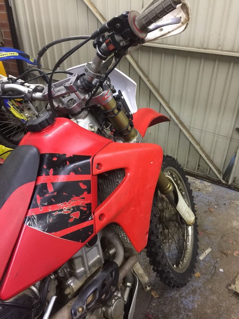

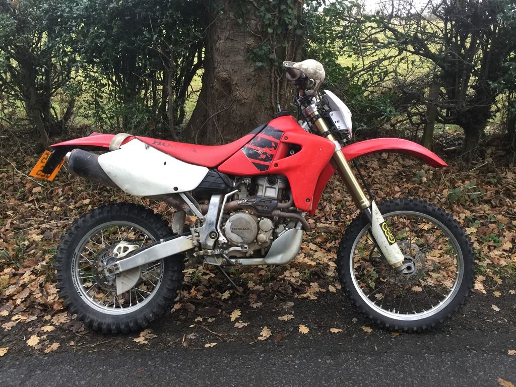

A quick road test today and all is well. On the dirt tomorrow. Bananatool

Nice looking Bike Hew! what year CRF front forks did you use as i am looking to convert mine and did they bolt right up or did you have to do some modding?

The 2005 -? seem to be good to use as the steering stops on the bottom yoke/tripple tree are a match.
You will need the complete front end including wheel and spindle. You will also need the Crf brake hanger but the brake caliper is the same.
The one area that does need a bit of modding is the steering stem. I pressed the CRF stem out and pressed the XR stem in using the standard XR steering head bearings. The only problem with this is that the CRF top clamp is thicker than the XR and there is only enough threads showing for the top nut to go partially on. If the ride today is successful then I will have the top yoke/tree machined to the same thickness as the XR one in bearing area as part of fitting the steering damper. It is possible to use the CRF stem as its longer but I understand that this needs a different bearing but I did not investigate this so dont have the details.
A couple of other things to bear in mind. It is the CRF R moto cross forks that are most common and these will be very harsh for trail/enduro riding and will need revalving to be really good. Front mudguard did need a couple of washers on the back mount to tilt it away from the rads but a nice new CRF one should be fine.

Well all good on the first ride. I will need to tweek the clickers a bit to fine tune it but stage 2 is also completed now.

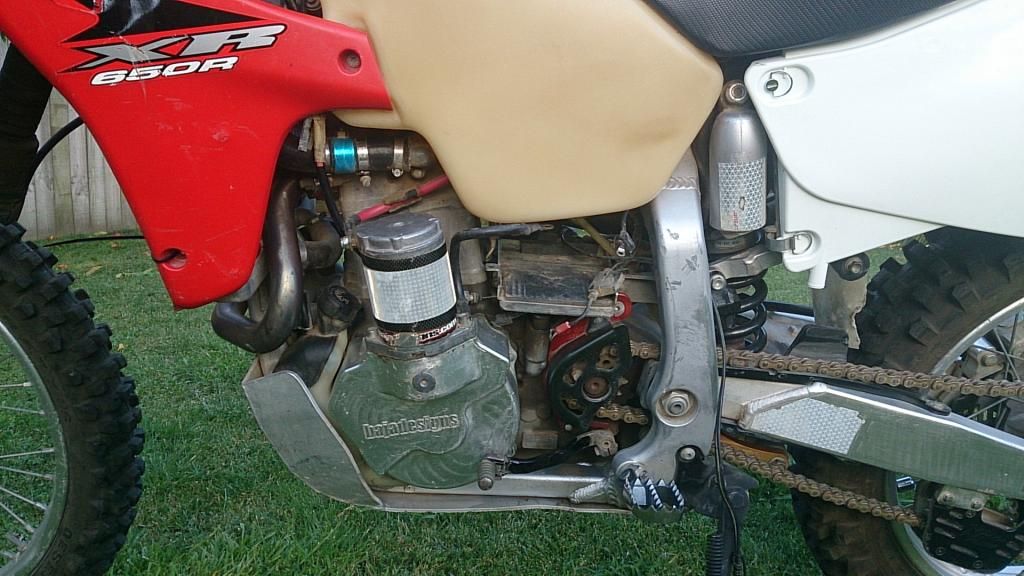

Nice work! Once set up I can't see how they are not a massive improvement over the stock forks. I have an old electric boot, turned the bike over ok but holy crap it's massive. No battery fitted in this pic it sits on tray above front sprocket. I haven't ridden this bike yet, previous owner did a number on it. Its in bits now waiting patiently for my time.
