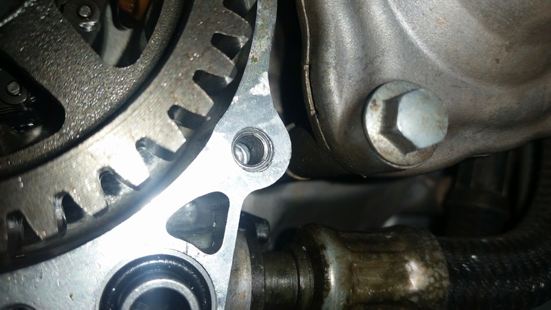

Post  theironblitz on Sun Apr 09, 2017 5:34 am
Yeah, I've helicoiled the two stripped threads. The reason that happened is that the cover wasn't going on flush and I used bolts that had caught maybe only a thread or two to pull it flush. Rookie mistake. Besides that, I played a little musical chairs with the bolts. Got a brand new one from Honda fer one of em and two are from the local hardware store. The gasket that I ripped, ripped to the outside of a bolt hole, so I think it'll still do its job of gasketing. Even if it does not, I have another new one. So now the question is of removing the friggin clutch basket stake, so I can remover the idler, so I can remove the kickstarter gear and replace the spring. Looks like I've managed to wedge down the inner/ lower material of the nut stake rather than push it away from the shaft groove.

Post  Mauser on Sun Apr 09, 2017 8:37 am
I think you will need either a clutch holding tool...
Gross Incompetence S-l1600
Or a rattle gun same as they use in the tyre/tire shop to remove the wheel nuts....both are cheap and will do the job....but no good if you don't have an airline.... BRP smile
