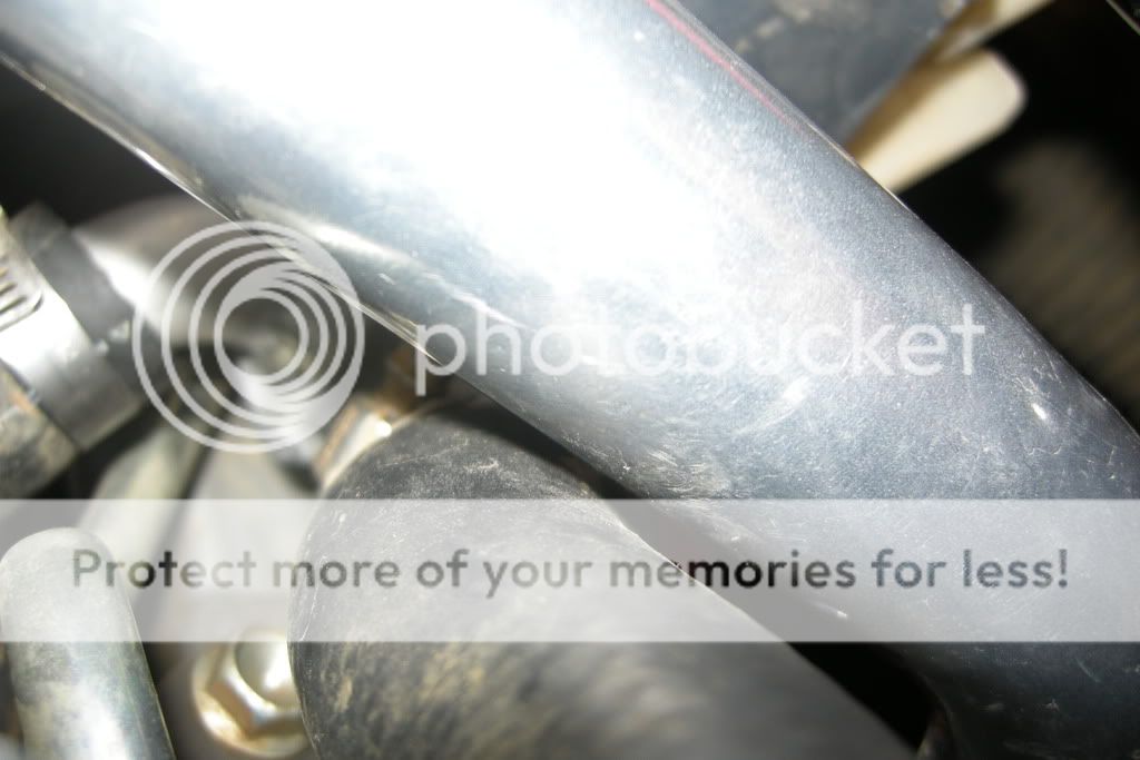

However, the T-4 fitment, combined with the Fluidyne radiators fitment, and the 4.6 IMS tank fitment somehow caused a change in one radiator hose. No matter what I tried the hose rubs on the pipe. So I've taken the water pump off and am in the process of cutting, grinding, and welding back together the exhaust outlet for the water pump. Will post After photo when I get it all back together. Here's the Before photo.

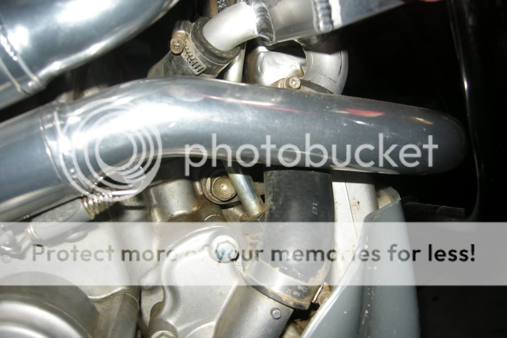

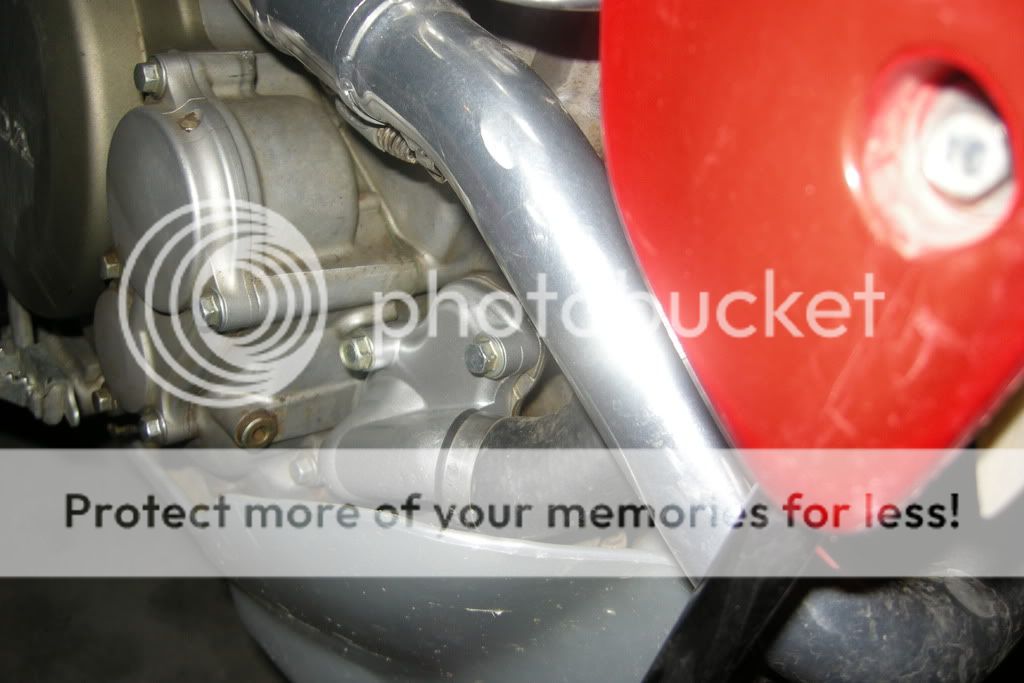

After Photos
Post  Bump on Fri Feb 13, 2009 1:10 am
Got it all done and back together.
Cut, ground, weld, bead blast, some clear lacquer, voila; I got clearance.
