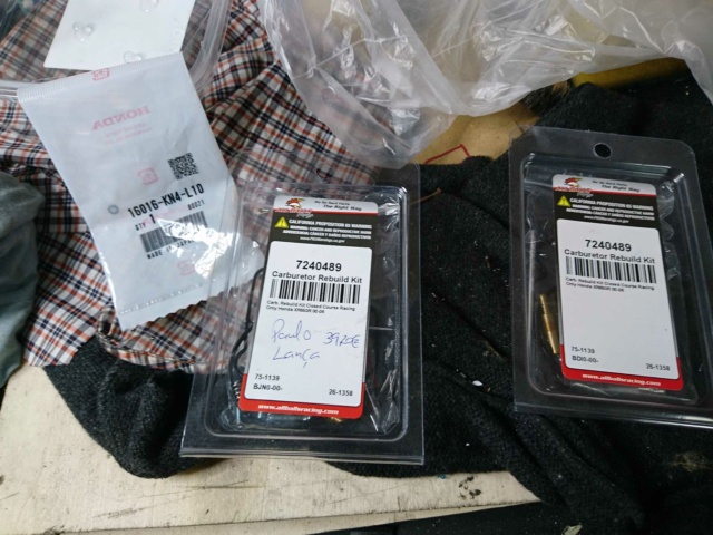

Thanks for your tips, am going to follow it all.
I did not touch the engine, as it was running good………. But we never know what PO did, he said it was rebuilt (going to measure compression ratio also).
I´ll Start with the valve play, (problem it’s the fan…. Its making more difficult access to the cover valves, probably I’ll have to remove it.
Then remove carb and clean it, understand what jets do I have, jet needle - how many grooves.
Finally recheck cables, and fit carb.
If no good, will fit the extra carb with the original settings (jet pilot 65 and main 175)
Still do not have the diaphragm (no stock from Honda), but am going to replace it anyway.

And while am waiting for the carb spare parts, probably will swap the carbs, just need time!!!!

Mauser, I understand you perfectly, but I was waiting for spare parts, I ordered from 3 different places, two from eBay and local store and Honda dealer, came all at same time (two weeks ago, insulator came this week, with air cut valve), cause the carb that I got came to me dissembled, and with some issues also. Already has epoxy glue on the inside (next to pilot screw.)
Swap done, Valve clearance checked ok: 0,15 - 0,20mm intake-exhaust

1-Settings of my Carb - fitted in the Xr:
Low jet 68S, 178 and needle 2rings from top.
(Showed wearing marks on the throttle link shaft and throttle valve piston)
2– Settings Carb I get now:
Low jet 68S, 175 and 3rings from top.
Note: for me also important was a tiny 5MM screw, fitted on the left side of the engine head, beside the insulator, I changed the washer and tightened the screw better.
After a few drive tests, She’s running fine no more problems with stuck rpms…… while changing gears (think problem its solved)
I seems to me that she´s not so powerful at high rpm.
So I have to thank you, Mauser and Burp……. all for the support and patience you had with me.
If I may help someone, let me know.
